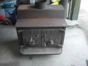

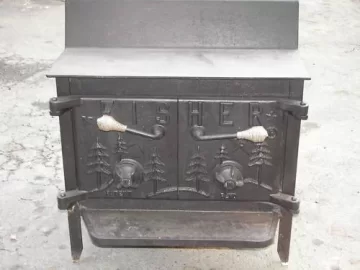

Are your legs tapered with chrome balls, or cut at a short 45* angle like the stove pictured below? I believe this would be the Grandma to match your Grandpa. The doors were sent out to be nickel plated, they were not like that originally. It shows how each door hinge should set on each plate, and this has the older draft caps with later springs to match yours. It also has the shorter trees, unlike the tall older style.
Below is a 29 1/2 wide Grandpa Bear (older, with tall trees) that the hinges stick out beyond the stove to fit the doors. Yours probably has more room from the door edge to the stove edge so the hinges don't stick out. Seen 'em, don't know the story.
Far right is a picture of of the wider 32" Grandpa.
