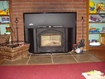

My living room is smaller then yours and If I wanted to I could cook the family right out of there but with the insert you really have the control of the heat out put.If you buy one of them grates you still have to baby sit the fire place with the insert you can load it shut the door and for get about it for hours on end.I was going to do the same thing your thinking of and Im glad I didnt waste my money on the grate. Good luck
