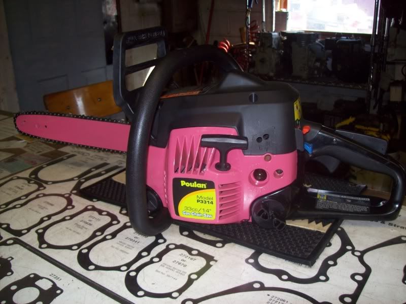

While I'm not crazy about my Echo in anything bigger than 8", it'll go about twice as long as the 036 on a tank of gas, takes about 2/3 of the time to file a chain, and when I'm getting tired is still easy to maneuver, whereas the 036 feels like an anchor. Faster, but heavier and more prone to close calls if tired, and potentially more dangerous. Dragging around a heavy saw in a big top gets old. I was in the top of a red maple with a 30" DBH trunk a couple of weeks ago, but I had loaned the Echo out, and I found I just wasn't comfortable with the Stihl. My buddy with his 029 tried out the Echo on a different tree and preferred it to the bigger saw to make headway in the stuff from 6" on down. Get a second, smaller saw (less than 40cc's) if you can afford it. But, for Pete's sake, NOT A PINK ONE! Sheesh...
