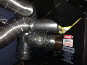

I have 2 Harmans and 2 nice OAK adapters
Below is my 3" Harman OAK adapter for a nice tight fit! ! ! :)
Also see our cast iron Vacuum Cleanout for easy vent cleaning at the bottom of the pic. :-)
Also see our cast iron Vacuum Cleanout for easy vent cleaning at the bottom of the pic. :)
