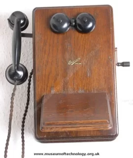

The old crank style phones need a battery for the DC circuit that handles the voice but the bell is run by the crank and doesnt require a battery. Therefore the crank from the telephone could be mounted outside with the bell inside. When I was growing up army surplus crank generators were easy to get and some folks used them to get earthworms for fishing. These days I think they are no regarded as antiques.
Best idea I've seen in a while. I actually have three of those, but they're mounted in 100 year old phones (which we still use, actually). I just replace the local battery circuit with a transformer from a Western Electric 302, which are plentiful.
