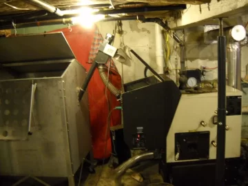

I purchased 9 tons green supremes at season start. immediately I started to have problems with my lift auger in the bulk hopper breaking up the pellets. Very noisy and the process left aprox 1/2 of the pellets broken up into dust! I used graphite and it would quiet it down for a few days.
since I suspect this spring we will have problems locating pellets due to shortages created by super cold weather, with 3+ tons of pellets left I purchased 1 ton of stove chow. My bulk hopper is so quiet I thought it was broken!.
I have a call into New England pellets to see if I can get to the bottom of this. I cant see any difference between pellets but I can assure you its the pellets causing this problem. As for burning and ash...green supremes are definitely acceptable...IMHO.
This hopper has used the following pellets without ANY problems...O Malleys, stove chow, north americans, barefoots, sommersets, vermonts.
Anyone have any idea what gives?

My stove (and yours will too) burned everything A... OK Its a Harman! The only problem is the lift auger (5 foot lift) [Hearth.com] Green supremes not working with Harman bulk hopper
I see, what a contraption you have going on there !
works great!! Just another way to make the stove conform more to MY schedule...not me working my schedule around it!! Its a nice feeling falling asleep on the couch...waking up and going strait to bed!!!
