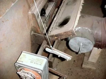

I have had this problem, and my unit is sealed up tight. It occurs mostly in the shoulder season when it idles a lot. The intake tubes are angled up, so you can imagine when the draft door is closed, that smoldering hot smokey stuff drifts right up the tubes and sits. Couple things that have helped.....put insulation on the draft door, and insulated the boiler room so the whole unit is in 65-70* I'll let it build up a little then scrape it off...no biggie. I also think your settings are just fine...I've been experimenting with my aquastat settings a lot this year and have realized I do just fine with 170* water max. Right now I'm set at 160-on 170-off and the dump zone comes on at 150, this works well to keep my shop warm, the boiler from idling to much......but shuts off later in the day when the fire is down and I need the refractory storage to maintain the house till I get home. I have the same setup as you ( forced air furnace with water to air heat exchanger ) and still don't loose temp in the house with 140* water when I get home at 7:00.
Found a pic of the draft door build up, and if you look close you can see the insulation on the door...
  • [Hearth.com] GREENWOOD 200 DAMPER DOOR BUILDUP
