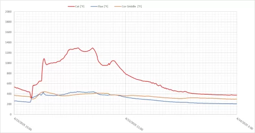

The first plot is what I would call a typical burn,
  • Flue temp is from a probe in the exhuast gas about 12" above the top of the stove.
  • Cat temp is in the gas about 1" downstream of the cat
  • Griddle temp is metal temp measured in the center of the griddle twords the back of the stove

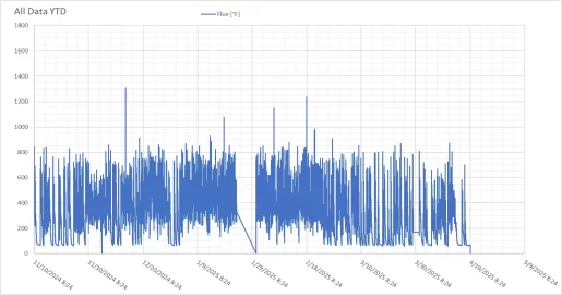

This plot is flue temp for the entire burn season. Hard to see details here but you can see typically my flue temps are 300 - 600.

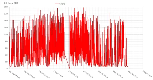

Same plot but for the Cat..... this is why I think my cats don't last. I started the season with a new metal cat from Midwest Hearth. Interesting how the mid winter spikes seem to be worse, could be I was running it harder or maybe it was increase draft from colder outside air temps.

Nice data. Yes, those spikes above 1600º are not good for the cat. It would be interesting to see the flue temperature higher up so that it shows pipe temp instead of the stove exhaust temp.

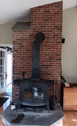

Damper: I agree it seems like a damper would help, which is why I have run one for years, you can see it in the pic on the vertical section out of the stove bout 18" up, handle is on the left side. A couple years back I actualy made a seat for it to seal off the gaps around the circumference of the disc and blocked up all the holes in the plate. It seal pretty good now.....

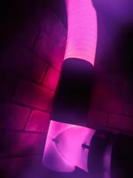

Agreed. I have the Auber AW-TMB-Deluxe wifi monitor which sent the alarm to my phone at 1am as the temps crossed 1650. Of course I touched the stove controls trying to stop it which only got it going more and eventually topped out at 1740 with the pipe glowing red. Lesson now learned from woodsplitter67, don't touch it. That black section in the pic is a section of black pipe loosely wrapped around so you don't see the stainless pipe coming down.
My old stove, high is high, low is low, off is off. With the Encore, low can go ballistic and there is no off. That's why I don't trust it.
