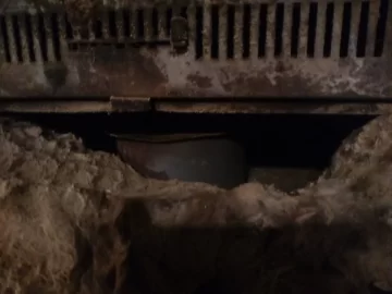

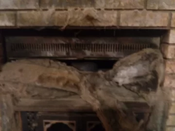

I've had that metal plate off once a few years ago. Seems like it has some fiberglass insulation but I don't remember what else. Going to get a screwdriver...

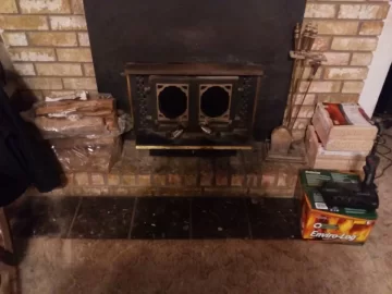

I believe that tile is marble. Probably an inch thick and just a simple concrete slab underneath.
Ok then you are fine for floor protection good.
Well that looks much better but what is behind that metal plate? And what is under the tile on the floor
I don't know what to call this stuff. Some kind of heat radiator or something???

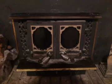

Here's the top of the Grizzly. Sorry it's so dark, I don't think my tablet has a flash!
