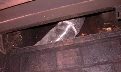

Dropped the 6" insulated flex liner down the chimney today. Couldn't get through the throat at the damper. The steel throat measures 5" across. As shown in the picture.
What to do? I would prefer a solution that would allow some future owner to return the fireplace back to an open fireplace if they so desired. I don't want to go in there and hack the throat frame all up.

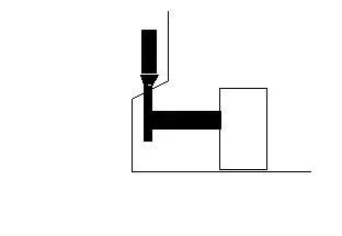

How about feed the 6" liner into an ovalized T section, then, connect the 6" stove exhaust right to that ovalized T, like in the diagram below.

Just cut it! Who in their right mind would ever go back? lol Make it as easy as possible to clean. I wouldn't go oval then back.
Right, cut it. Don't use oval, you'll create a flow restriction, just like when you squeeze a garden hose.
Branchburner has it right.

But is it possible that this frame has any kind of structural function? Like supporting brickwork? I don't want to do anything that I'd regret.
My installer removed that back angle iron ledge part and the two bricks directly under it (like yours, my vestal damper was built into the masonry) and the liner comes straight down and in, then. If you do something like that, obviously you have to make sure your chimney has more masonry under and in back of those bricks. (I can't imagine that it wouldn't, but I guess there's all kinds of builds out there!) we saved the bricks and it would be an easy fix to put them back and put in a top damper if in the future the fireplace needs to return to it's original function.

Just cut it.
My frame is built into the masonry, but my cutting consisted only of going through a piece of angle iron (at two points) that was free of the masonry. So that made it pretty easy.
The other verse to the tune is that yes there are a lot of stoves installed with the oval to round flex with oval tee. More difficult to brush but they are out there.
I had the same setup. Cut it back in 2000 and haven't looked back. It's nice running the brush down and cleaning the whole pipe.
