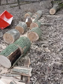

Just cut this yesterday, those big rounds toward the trunk were at 26%. Pieces about 20 feet up, about 14" diameter were 23%. Haven't checked any from the tops. This tree is about 50 yards from the river and was under 10 feet of water this spring.
