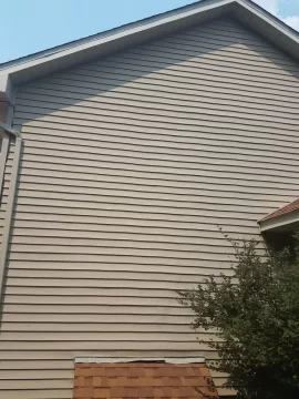

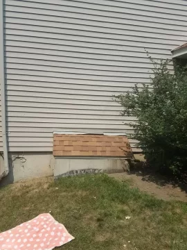

Thanks for commenting, I was starting to get the feeling I wasn't going to get any help. Tomorrow I can measure to the roof. I'm not sure what pics you would like, there is a a finished wall across the fireplace footing opening. The outside width of the footing was just over 5 feet.

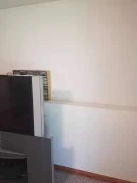

There is no chimney, just the outside footing. Basement is finished and insulated, I would need to cut out the studs and sheet rock where the FP footing is. Then I will need to build the chase on the outside of the house and run the appropriate pipe etc.
I know I can buy a fireplace with the insulated door for around 3500, why is just the door 1000 dollars? I was hoping maybe someone would tell me where I might find a cheaper one.
Can I even put a stand alone wood stove into the nook created by the FP footing?
The FP footing sticks out from the house 24" X 64" wide.
I am not able to get on the roof but measured as high as I could and it's about 20' from the peak to top of the concrete in the pick.
