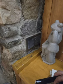

pretty well have myself sold on a osburn horizon now. going to pull the old firebacking out and cut the stone above to fit the thing in there. have a couple questions for set up though.
the two vents on the side of the fireplace are connected by a square tube behind the firebacking and im going to have to cut that out but im wondering if it lines up close enough if i could knock out the gravity vents on the unit and leave it unhooked and just let the heat naturally find its way out of the vents or is that a recipe for disaster?

I have a similar fireplace in a cabin we purchased 4 years ago. We inherited a converted wood-to-LP gas setup installed with a Blaze King 8003 insert. We are having an immediate issue with the unit not shutting off (running continously), even when thermostat is turned off. So this needs to be fixed ASAP. But more broadly, the installation was rather janky and there are gaps on the sides that they stuffed with insulation. Looks TERRIBLE. I'm wondering if there are now better solutions that could replace this unit?
The same issue will be present with a new insert if it is switched back to wood. The issue is the rough stone opening. One option is to have custom, scribed panels cut and then attached as wings to fill the gaps where the insulation is now used. The much smaller gaps then could be caulked with black silicone.
