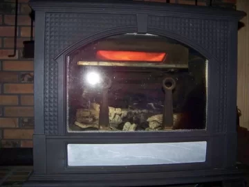

Loaded up the stove full with some White Birch and a chunk of Super Cedar and she took off fast, within 20 minutes the new cat probe was up to 450 while the stove top was only 100. I decided to engage the cat with air setting of #1.5 since the new s/s cat is suppose to light off at 400. 10 minutes later the cat temp was at 1000, stove top 350. I'm liking this cat probe, last year I would of waited for the stove temp to come up to at least 200 before light off, much quicker now.
At the 60 minute mark the probe was reading 1400, stove top 550 and external pipe temp 290. Turned it down to #1 and stove top stabilized at 570, probe 1300, pipe 250. I burned this way for 15-20 minutes with that familiar floating fire burn then turned it down to .75 which snuffed out the flames and turned the cat beet red. The first 20 minutes after turning it down the stove top rose to 600, probe back up to 1400 but the stove pipe dropped to 210. I've noticed this rise in temps in the past when you snuff out the flames, gives the cat more fuel to burn. The old Fireview use to run away occasionally up over 700 when I did this but the Keystones haven't done this yet.
Another 20 minutes and the temps started to slowly recede. Everything was looking good so I went to bed in a nice toasty house. Next morning 9 hours after match light the stove was 200, probe was 400 and I had enough coals for an instant relight but just let it go out since the house stayed up to temp. Probably do the same tonight.
Here's a pic of that low cat burn, looks like I need to clean my glass, low burns in the shoulder season seems to get that corner a little dirty.

I love those pics of non-fires with the cat glowing.

Nice to see you back on the forum jpl. I noticed exactly what you describe about the Birch, very smokey at start up, that's when my glass darkened up and once she warmed up it burned most off except the lower corners. I think I'll mix in some oak and stick the birch in the back of the stove to see if it makes a difference next time.

Being a cat burner that stove burning low with a beet red cat is a beautiful site to me, my sister has that DW too, nice stove.

Ya, birch in the back on the bottom, bark down. By the time the burn reaches it the stove is already hot enough so the smoke combusts instead of getting all over the glass. Even in dead winter, I keep all the birches, (white, yellow, black) away from the glass, same with pine and hemlock too.

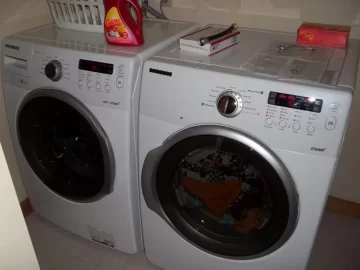

EDIT: I just looked it up on ebay the digital ones are 4" and Condar also has a 4" regular probe for $24. Looks like the 2.5" one may also be too short? I just got rid of my Encore and got a brand new front loading washer and dryer set for it!
