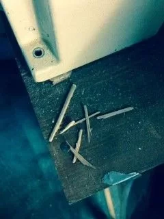

[Hearth.com] Hamers.....Way too much ash to handle in my 25-PDV!!!!! Wow scored that lowes deal to, mine have hardly any ash and are burning very good.... The only thing I see is a bunch of big fines, well chuncks in my bags.
Have to sift these or u are going to get a auger jam.
Reactions: jjones139
View attachment 125866 Wow scored that lowes deal to, mine have hardly any ash and are burning very good.... The only thing I see is a bunch of big fines, well chuncks in my bags.
What's up with the chunks? That's kinda odd!! Happy burning....
More like splinters, but the price was killer and my quad loves them
