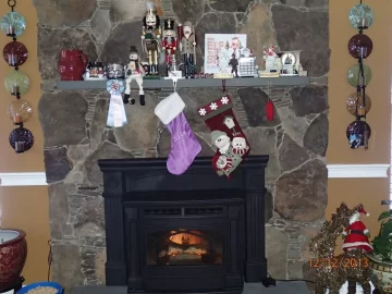

Thank you all so much, this is the info that I needed that isn't mentioned in the manual, but is acquired via experience! Thank you for sharing your insights with me! Having it for a week, I am getting to know it much better and it is succeeding in what I bought it for - heating my lower level of the house - the awesome thing is that it also heats my upstairs pretty well :) I absolutely love this purchase and wish that I had made it a few years ago. I will also say that I was very impressed with woodpellets.com - they shoe-horned 3 tons of pellets into a very tight garage space in less than ten minutes. I hope that the picture of the stove comes through - and thank you all again!
