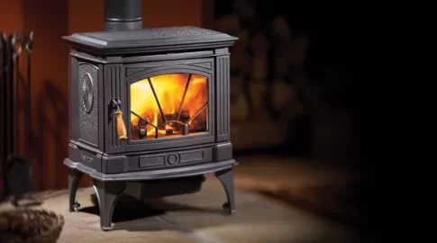

I am installing my new Hampton H200 and just trying to figure out where to put a stove thermometer. The top is a cast hob that sits above the actual stove top to allow convection air from the blower to exit. So the stove top won't do me much good. The next best place I figure will be the side up high. I will experiment of course, after I get it running but just wondered if anyone else has the same problem (because of stove design)
I also installed double wall chimney connector so I bought a Condar probe thermometer to measure flue gas temperatures since a surface mount would not do me any good......Unfortunately, I also just read a lot of threads on this probe thermometer and its accuracy. I have always monitored temps on my stove but seem to be running into a big problem doing that with this new install. Any ideas or experience would be welcome.

Seeing as though you have double wall chimney pipe (which is why I assume a magnetic will do you no good) then the condar should be OK. In general, the 3-39 probes seem to be reading high compared to the 3-19's. Keep things on that under 1000 and you should be good.
As far as the magnetic on the stove I would do just as you suggested and experiment with side placement. I ran a thermometer on the side of my stove for a year or so and it didn't read too much lower than my stove top. I'd say keep that magnetic under 650 and you should be good to go.
Beautiful stove BTW.

I was thinking, how much open space is there between the stoves actual top and that false external top? Any way an IR gun would shoot in there to get the temp of the real stove top?

I think placing it just at the front corner of the stove top, under the cast plate, so you can look through the slot and see the temp.
Will give you a good reading.
The one i burn as a display, i bring the stove pipe temp (18 inches from top of stove) and (single wall) up to 500 before i start to damper down. This helps to fire off the secondaries very nicely and bring the stove up to temp. When it settles in, i run it around 300 or so 3/4 of the way closed.
It's on a shared 8" chimney so i can't get away with closing it right off. The heat this stove can put out is impressive.
Looks great.

Great idea Pen, Again, don't know why I didn't think of that, but I am sure going to try it. After a few times I would know how that correlates with the surface one on the side. Thanks.

Install fire 1, so you have a Hampton H200 on display and burning in your shop? I will try that, but I don't think there is enough room to see what it says through the convection slot. The hob sits about 2 in from the stove top but the convection slot is much smaller, only about 3/4 in. and, I am afraid the convection air will cool the magnetic thermometer and give a false reading or at least relative to the situation. I guess I could run it with the fan off occasionally just to get a true stove top reading for reference.
