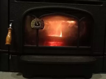

[Hearth.com] Hampton HI200 Temperature
I'm getting a reading of about 400 degrees F at the metal bar in front of the glass. Does that sound about right?
