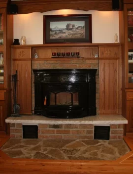

I have the same insert in the gloss black enamle finish, they are a GREAT unit. I do not have a thermometer, what kind are you using, I have been looking for one that will fit. To answer your question this unit really holds heat well. From load up of 5 mid sized maple splits, I can still reload 12 hours later and not need to use a match. Not sure if that is normal or not but my old wood stove there would be no way I could do that. I am very happy with the Hampton, it throws alot of heat and stays warm for a long long time. Here is my girl

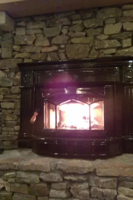

Here is a picture of my install.

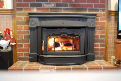

I'll take one tonight and post later. For now, here's a pic of where I placed mine (see red line). You can see it with the door closed but you need to get a flashlight on it to see the needle.

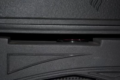

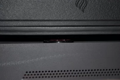

Here are the pics of the Rutland sitting on the stove top, not the shelf. nlittle suggested to put the thermometer upside down so you can see the arrow when its on the 600 to 700 range. Remember to have a flash light handy so you can see where the needle is when you look in there. I hope this helps.

Thanks for the info stejus. I placed my thermometer in the same spot but had the needle pointed the wrong way :) No worries as I did not burn last night. Thursday and Friday nights are supposed to be in the low 30's so I might be a burnin those nights.
