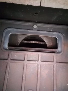

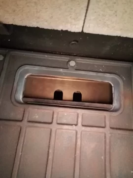

My question is about the damper plate or shield whatever regency is calling it. 2 pics are enclosed. Is it ok to start out with the shield completely open? Is it meant to be open? I have horrible draft, which we are working on , and need as much air as possible when fireing up. When I engaged the damper, it shuts the shield as well. I pretty sure the shield is set to ones preference? These are my questions and I appreciate any feedback. Best

Drop into the long thread for the Regency CI2600 to chat with some long term owners of this fireplace. @Wolves1 has been very helpful there.
It’s not a problem maybe, it just will take longer to reach 500. The problem that you could have is you need to be careful when you move the shield back it can move off track and when you close the bypass it won’t close properly.
So it's ok to start completely open? And yes, it already came off track. I was able to fix it without taking anything apart but, when I close the damper it pushes the shield aswell. I'm pretty sure that did not happen when I first used the stove. Anyhow, tomorrow temps will drop so I'll be using the stove again only second time since installed 2 weeks ago.
No problem as long as it hits 500. It’s always difficult to get a draft on a cold day and a cold chimney, If you would like to try again open a window near the stove have several peace’s of newspapers crumble long ways lite it on fire one at a time and but it right up to the bypass, if you haven’t done that already.

Make sure your chimney is clean the shield is also there to prevent chimney fires is it is dirty.
That shield is designed to reflect some heat to the catalyst when the bypass is open. As wolves said you can run with it pushed open but the cat may take longer to reach 500.
