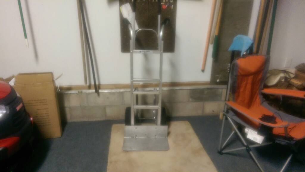

My brother just gave me an awesome rwm casters hand truck. Pneumatic wheels extended frame, the works. However , it's built for hauling boxes not round items. What would you suggest I attach to the frame in order to hold log rounds in without rolling off the side?
The parts list has a curved frame but it doesn't fit with the stair things and I don't want to lose them as this could be an all around tool not just for wood. Ideas?

It is, but I just put 2 large rounds on it and it was easy to move which is great, but a lot of wood I get is in backyards that are uneven and they will roll off the frame.
Could use my tire down straps or bungees but I'm looking for something like a curved aluminum part that I can mount. Just to create an edge sort of

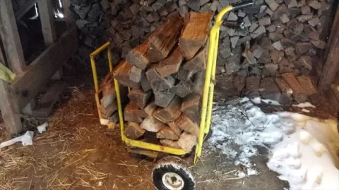

I really like this idea. Using this in combination with Jags easy peasy description, one could make a quick detachable fire wood hauler / hand truck. Drill two holes in the bottom plate for the firewood hauling frame to lock into, then have the top of the firewood hauling frame snap (by bending the frame) under an existing cross rail on the hand truck. ----Or I could just eat a BLT sandwich rather than go out to eat and use the savings to buy one. -----I'll have to ponder on that.
That one would be easier to load, and probably unload, that the one with the tubes over the top. Maybe not as rigid, but does it really have to be?
