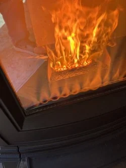

I have a brand new harman 63. I lit the the stove today and i have flames coming out of the bottom sides of the burn pot.
This does not seem normal?!? Anyone have any ideas?

The flame is coming out of the end of the ramp on the sides. It's happening when the stove is burning the hottest.

I would turn your feed rate down to 1, and check the vacuum per the manual. You may have too much vacuum.
I had the same issue with my Advance after replacing the upgraded burn pot. The cure was to put a narrow piece for ceramic gasket on the back of the flame guide to seal the gap between the back of the flame guide and top of the burn pot
