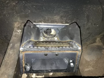

I was having trouble with my absolute 43 lighting, sometimes it would light and most of the time it wouldn't. After 2 trips from the dealer they noticed that I was missing the front igniter bracket. They had it mailed to me and I put it on and now it lights in 3-4 minutes every time.
Hope you got your absolute 43 problems rectified
I am a Harman tech and do know they have a issue with the burn pots on the absolute 43 and have totally redesigned it
They did do burner plate upgrades but they don’t work
All absolute 43 we sell I personally change the burn pot to the newer which has zero issues

The pic you posted is actually the 3rd gen. The second was just a modified plate with a 90 deg bend to help with warping, but didn’t.
Reactions: Pellettec
Yes your correct and works like a dream.
Just pointing out there is a fix to a known problem and all the burn pots on the absolute 43 need to be recalled and changed for the newer generation instead of dealing with the frustration of ignition and warping issues
