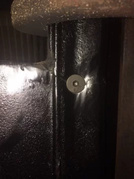

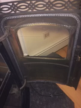

Guys , I think I have a major lower and handle side door leak. Here’s the story.......I had to take the door off and the Cast front frame off in order to drill the heat exchanger bolt off. Then on top of it ,I saw a crack in the front frame.had it welded and removed ,cleaned and replaced the gaskets on both. When I put it all back together, I noticed it didn’t take much pressure to latch the door closed. I used 3/8 gasket which is factory.
Think we have but what do I do. Take it all apart again or buy a thicker gasket for just the door. I mean there is zero resistance to latch the door. Also the gasket they sold me is gray as oppose to white that was originally there. Does that matter?
Sounds like front cast member may also be leaking,may be hard to notice if the whole frame is leaking,creating big leak that blower cannot compensate for.But,you saw a crack?wow,never saw a crack in an accentra,pictures please for us.
Honest truth,you should buy an magnehelic gauge(ebay is fine)and study it,while doing tests.(same as a professional does).Then you can use sealer,up and down the stove sides,while watching the meter.This is what a professional would do.Or you can just quickie caulk/seal the outer edges of the front cast member,and see what it does.But,what about the top and bottom?Do you trust your workmanship?Just thoughts.

Pics of crack

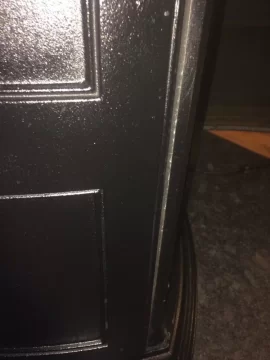

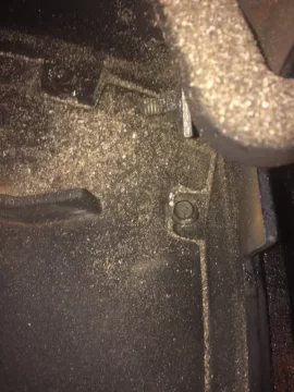

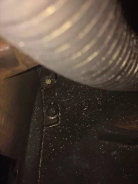

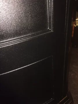

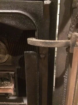

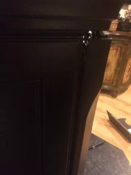

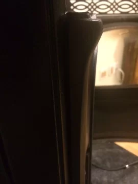

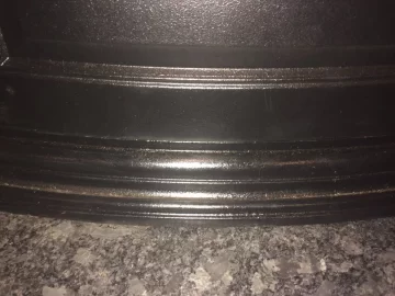

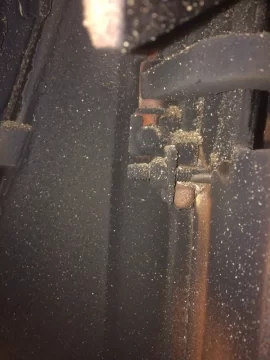

So did the dollar test and the dollar moves freely along the bottom. Good news we found the problem bad news I have to take this thing apart again. Take a look at my gaps, can anyone send pics of there lines along the side. My other pellet stove is not at this house to compare. I also included pics how the cast frame attaches. Maybe I attached it wrong(over tightening) On the rear of the frame the gasket only goes along the sides and top. the bottom sits on a gasket along the bottom plate. Anyone familiar with installing the frame and the door. I really didn't see any adjustments other then the bolts on the bottom which I clearly have to let out a bit judging by the lines

I would be inclined to disassemble and put the frame back on wet (bead of sealer on the flange)then smooth out excess after everything is tight.Cast iron does warp but not to the extent of sheet steel, did it have equal gaps before you tore it down for repairs?
