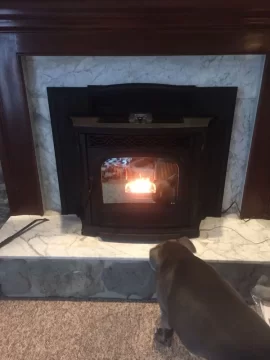

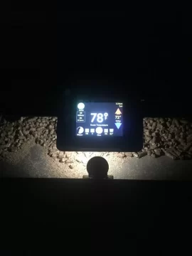

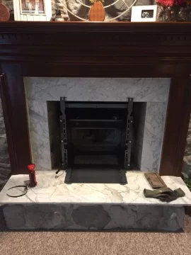

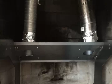

So I finally just got around to installing this stove in my new house and I love it. I have a lot to learn with these new digital controls. This time last year I installed the 52i in my old house and was happy with it. I’m not sure if they changed anything but this stove is very quiet compared to my old one. Now to get stocked up on pellets for the winter!! I will attach some photos

I keep mine on room temp at 72 and it only used 7lbs of pellets last night. It isn’t very cold here in Maryland yet. Is your model the tc?

Last year in my old house I installed the 52i with the old controls and always left the feed rate on 4 no matter what. I’m only on day two of running this new stove. My house is well insulated and room temp mode keeps it perfect for me and the fam right now. My old stove would go through a bag a day easy when it ran all day in cold temps. Everyone on here told me to keep the feed rate on 4 which I assume is the default setting on this stove and that any lower you are just robbing the stove of fuel and not letting it do its thing. The stove will self adjust the feed rate up to what you have it set at. I don’t know your weather conditions but give the room temp a try. Also, If you don’t want it turning on and off switch the ignitor to disabled and it will stay lit.
