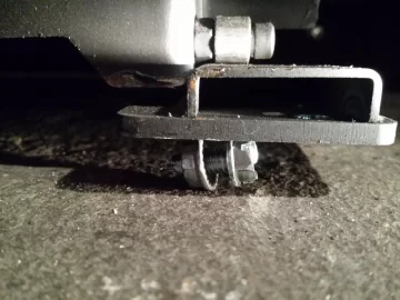

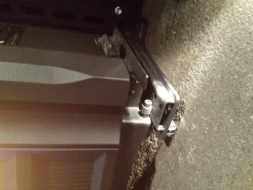

Harmans do make some strange noises, one thing they can do is make a rather loud pop when the slider in the feed assembly cuts a pellet in half. It's perfectly normal to have this noise. The noise you describe may or may not be normal as we can't hear it from here:p That being said if you have a concern then call the dealer, it's brand new. I don't like the sound of the wedged bolt being in there. Can you post a pic of this?
Thanks for the reply. Yes the stove is brand new. And i plan on contacting the dealer. Luckily they are only a few miles down the road but i have conflicting work hours with their hours, and i would rather just drive down and talk to someone, so i plan on waiting until the weekend. I will take a picture when i get home tonight. Basically there are 2 bolt/ nut assemblys (1 on under each rail) laying on their sides between the rails and the hearth. I have heard the stove cut a pellet or 2 in half. The popping noises i am referring to are much louder.. I may also take a video tonight of these popping noises.
So they are using the bolts to support the front of the rail because the hearth is about a 1/4" lower than the fie box. I removed the bolts to just see if it would stop the popping and. it doesn't seem to really improve at all.
the bolts aren't your noise, but looks a bit half-assed to me...
Yeah those bolts are not correct my accentra has bolts in the rail itself for support and leveling that's a very unprofessional shim job if those bolts were moved it could bend the frame or pull the bolts out of the floor in the rear of the frame.causing hazardous results when burning.
Seriously is that what is supporting the front of the stove?
Definitely half ass job by the installer. Makes me wonder what other half ass shortcuts he took during the install. Those loud popping noises may be related to a piss poor installation.
Reactions: Irish916
Agreed. Where there is smoke, there is bound to be fire. Someone who would do that probably took a bunch of major shortcuts in other places during the install.
Agreed. I am now wondering if the noises maybe related to something being not level. Maybe some sort of uneven pressure on the unit its self. Seems as any time i open the door and release the door pressure during heating and cooling i can produce the popping noises,
They seem to be coming towards the top inner portion of the fire box.(somewhere around the heat distribution channel/ exit). I was home during the install (although not standing over the guys) but it seemed other than the bolt spacer situation seemed liek they took their time and did a good job as far as i can tell.
Why did they use the bolts? It seems that they raised the unit up off the hearth? Was there a reason for that? Was this a zero clearance install?
well the base on the inside of the fire place is about 1/4" or so higher than the hearth. There was a ton of space for the install.
How much did you pay for said installation? Whatever you paid should have better end results. The "half assed" bolt shimama-bobs thing is ridiculous! NO EXCUSE! I have a Lopi wood insert but not familiar with the pellet inserts. Not much different I'd think. My P68 free standing came with leveling bolts if needed. They sure as hell aren't supposed to be used as jack up slip under crap. I would think the installers would carry say some plate steel in different thicknesses for shimming. You said 1/4'. Well guess what, they make 1/4' plate steel.
Looks like a Q & D install. Quick and Dirty! I'd be slightly pissed. Make them come out and get it right. You paid for a correct install so you should have gotten one.
The harman accentra already has leveling bolts built into the frame from the factory no excuse for that at all
That's scary the "installer" was unaware of them. Huh? ...... _g Things that make you go, Hummmmm. I'm a contractor and see the work of hacks on a regular basis. It's sad.
I think what happened is they slid the stove in and realized they didn't level the front of the frame.instead of pulling the stove back out this was their quick fix
Reactions: twodogs02
Yea, nothing a crow bar and a couple of bolts won't take care of. Must have been beer : 30. Quitt'in time.
Reactions: Big papa
I think if they weren't in such a hurry and they used the correct bolts to begin with it would have still taken them less time than the shims.thats stupid!
Truthfully the bolts are not a huge concern themselves. They only warn me that maybe the install was rushed and not done as well as it should have. I can easily make and replace them with shims at work, (although i shouldn't have to and am contacting the installer on this issue as well as the noises). The major concern are the noises coming from the stove and what is causing them. I had the day off from work today and took some video if the noises. Could you guys take a look and confirm with me that these are NOT normal...? I just want to make sure in case i get a response from the dealer that popping and tinging noises are normal. I mean it says they are in the manual but i think that these are pretty extreme. Also note that this video was edited, first few seconds are during warm up and the others are during cool down. This is multiple clips put together. I would say that the stove pops or makes some sort of popping noise about every minuet or so until fully warm and than agian during cool down these. Thanks all!. (don't mind my dog walking around the hard wood flooring :) )
