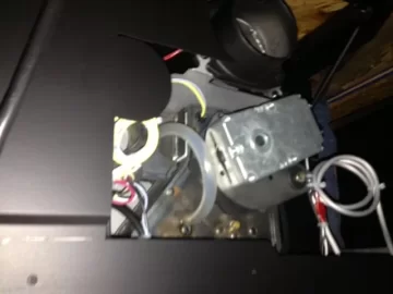

Can someone tell me the difference;is it a pro or con having these two different drives
on a Harman Accentra? :ZZZ
I recently purchased a used one, 2008 model, and in cleaning it up found the chain drive.
Good feature or not? ;?
i dont think there's really a pro/con to having or not having the chain drive...they're just different. Same basic function.
Harman has done away with the chain drive. This is the new Advance but same thing. To me the less parts the better that is why I am a Glock fan.
