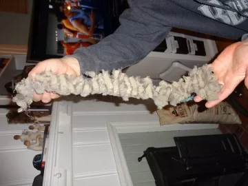

Solution - cleaned the distribution blower fan.
If you've never done this before, it probably needs cleaning. It is underneath the unit. I pulled the stove out and (with help) laid it on it's side onto some couch cushions and an old blanket. I found a massive clot of lint, hair, debris, wrapped into the intake, which undoubtedly would not let it run properly. Afterwards, the stove ran like new.
  • [Hearth.com] Harman Accentra distribution blower shuts off
Whoa, that thing looks like a small intestine!

Most small motors are "thermally protected". That means that they often have a thermal switch in them that shuts off the power if they get too hot. Given enough time to cool down they restart. With the intake blocked by whatever that is, the motor cannot cool itself.
Blower cleaning has to be a part of annual maintenance otherwise, efficiency of the heat exchanger drops off and your heat goes out the vent.
