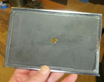

I happened to have my stove shutdown for a deep clean. The gasket is 0.120" thick or about 1/8". I'm not sure what the material is but it feels like it's neoprene.
Yours is in much better shape than mine...I'm betting I can seal up some minor leaks by replacing the fabric.
I'm wondering if there is a need for high temp stuff, but for the minimal cost by buying in "bulk" it's probable better to have.
Many thanks for taking the time to post...immensely helpful. (if you ever need some for replacing yours get n touch...Im betting I'll have quite a bit left over after the purchase)

It is a similar foam type gasket like on my hopper lid. I wouldn't pay $36 - $38 bucks for that thing. The metal cover would never go bad unless you have it off and step on it. Don't even think that would hurt it. I would look around hardware stores or the net. I do not think it needs to be flame resistant either. The factory stuff isn't I bet.
I'd just scrape it and find some new foam and use contact cement sold in small bottles with a dapping Q-Tip looking applicator on the lid. Kind of a minature version of PVC glue and cleaner lids if you've ever seen those.
Hell, I would probably just glue another piece of foam over the old. It's not that critical and the wing nut would snug it down to where it needs to live. Or maybe find a small roll of similar foam material (many have adhesive backs) and put that around where it is needed. You can clearly see the line on the foam gasket when you take the cover off.
the gasket material from amazon has a heat rating 450F max/500F intermittent ... seems to be the same as gaskets that are used on the inspection ports on my stove body. Never hurts to have heat rated in a hot environment:) Still far cheaper than the 2 pack kits!
