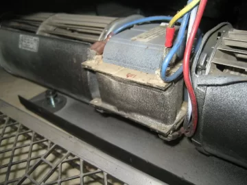

Here's a pic of how it's attached on my stove. The ground wire is the one with the red lug. I replaced my distribution blower a couple months ago and took the pics as an aid in the repair.
Looks as if you are grounded right in the motor.
The pic is of the factory installed blower just before I took it off. I wanted to remember which wires go where. When I replaced the blower I put it back together exactly the same way.
My old one was wired exactly like yours. I wired the new one just like the old one. Fan seems to blow very good at 3/4 turned up. At half or below hardly anything being blown. Turn the knob so it will not go any more then the blower cuts out and the status light goes off. Perhaps with this fan the wires have to be switched somewhere?
