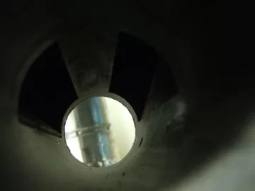

Pictures are:
1. Outer hole plugged up with a bolt head
2. Windows above the auger tube are clean :)
3. 1/4" hole in the auger tube

To perform the mod two holes are drilled, but only one hole remains open in the end result. The first hole is drilled to gain access to the auger tube from the weldment. After the auger tube hole is drilled the access hole is plugged up. See my pics above where I used a bolt with RTV to plug up the first hole. Once you get into the stove to do this job it will make sense. The diagrams above are very clear. The first hole is drilled in the auger tube weldment, then through that hole the auger tube is drilled. Then the weldment hole is plugged up. Hope that's clear.

If you do the mod I did, you do not need a kit or tubes or anything like that. The 1/4" hole in the auger tube accomplishes the same thing as the bypass tube. The idea is to introduce some induction air (air flow produced by combustion fan motor) into the auger tube. Where exactly the air enters the tube is not important. This air flow prevents the gases from going up the auger tube, into the feeder and hopper. The bypass tube takes some air from the induction chute and sends it into the auger tube. The hole mod does exactly the same thing without any tubes. When you drill the whole as per diagram you create a shunt for the induction air into the auger tube. Either mod does the trick. Whatever you find easier to do is what you do. I have not heard of any kit for the tube mod, but 3/8" tubing is easy to come by. You do not need any ferrules, just use some RTV to cement the tube at both ends. The air traveling through it will not be hot at all (induction air from wherever you get induction air - outside in my case or room ambient) There is not much heat at that part of the stove, so I guess any 3/8" tube will do. I've seen people do it with copper ice maker tubing as well as with clear aquarium pump tubing. Whatever you like. I like the hole mod I did because it eliminates many of these questions and provides a very direct path for air to enter the auger tube. Also the hole mod has no points of potential failure, whereas the tube mod has several. The tube itself can fail, as well as both ends of the tube are points of potential failure and leaks. I found the hole mod much more sound, so that's what I did. So far it's been a season and a half since my mod (and cleaning) was done and no sign of any gummyness or smoke in the hopper. No shutdowns either, so I assume the mod worked for me.
