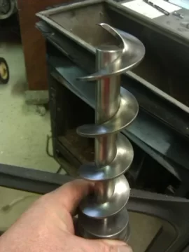

My Harman Accentra insert had an odd auger tip from the day it was purchased. Looked like the tip had been hammered down thinner then a dime, spoon like look on end, slight crack where the metal went back to full thickness. Sure enough the tip broke off, about 1/4 inch. It still works, but I would like to replace it, I have the part.
Anyone have the instructions for replacing it?

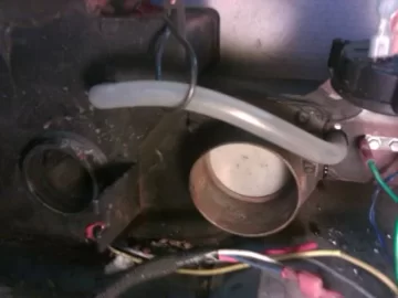

Get the auger motor off. Take out the two screws that hold the auger in place. From the front, use a dowel or the back of a hammer and tap the auger out. While your in there, clean the auger tube. Mine was a sticky mess. Hot water soaked rags until clean. I installed an air draft tube at the time and put everything back together. I used a little sealant around the sides of the auger housing. Tighten the two auger screws back an forth so nothing gets in a bind. Turn auger by hand the make sure it spins freely. Done.
