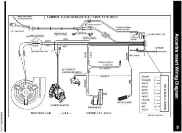

This is a wierd problem because unlike most stoves there is no low limit snap disc controlling this function. The stove is approx 4 years old and works well otherwise. It is on a power strip but does not look like a surge protector. So is it a bad control board? What else can it be?
Couple of pages from the manual attached below. Click to enlarge.
