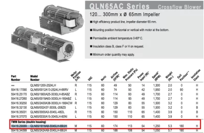

For the accentra insert it is Fasco b47120 .. around 115 bucks or so.. there will be 2 wires that you don’t use on it (low med ) the harman board regulates speed
I was able to purchase the OEM blower from my local Harman dealer. These part numbers may be different for the Accentra insert.

Thanks - will those wires be obvious?
Yes it’s the high speed wire, it is the same oem blower.. just without the markup , the 2 wires that aren’t needed , cut and cap them using either tape or a crimp connector, you will not use the housing unless you want to take the whole stove apart lol, just the motor and wheel which attaches with 3 bolts. If you need more connectors to attach to your stove usually auto parts stores have them.
