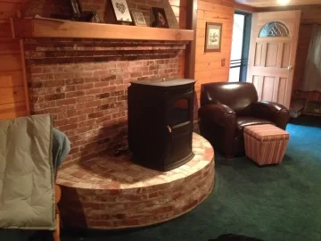

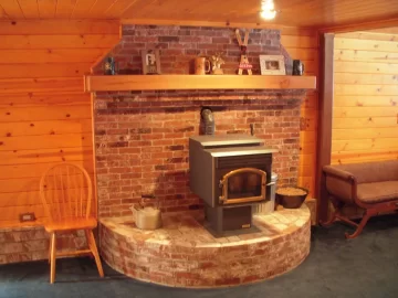

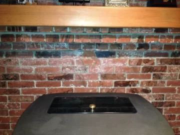

Photo 1 - Old pellet stove that needed to be replaced.
[Hearth.com] Harman Accentra Pellet Stove Install Photos

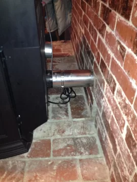

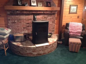

Photo 2 - New Accentra in place with old venting still showing.

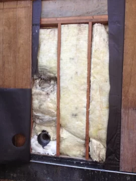

Photo 3 - Old venting removed and hole in brick that needed to be patched.

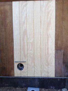

Photo 4 - Old hole in brick patched.

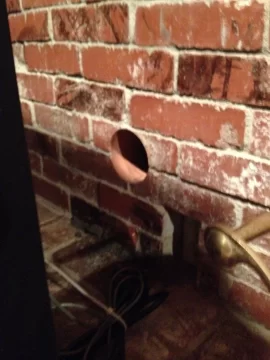

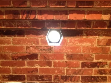

Photo 5 - New hole cut through brick for new exhaust.
Photo 6 - New 3" exhaust installed through brick.

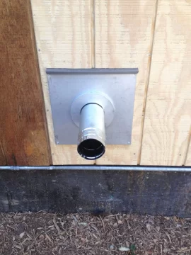

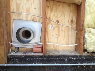

Photo 7 - Thimble install in wall from outside.
Photo 8 - Insulation back in place around thimble.

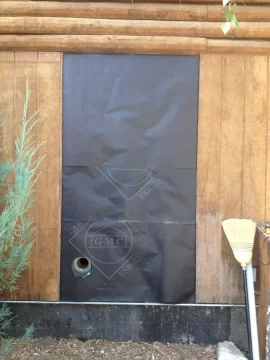

Photo 9 - Black paper patched.

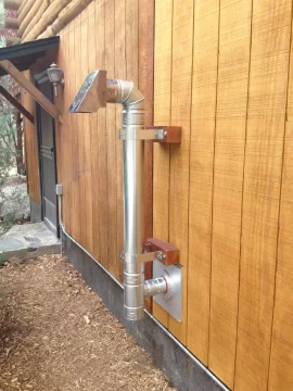

Photo 11 - Exterior portion of thimble in place.
Photo 12 - 3" to 4" clean-out tee and 36" of vertical 4" pipe with termination cap.

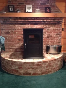

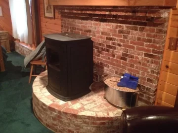

Photo 13 - Final install photos.
Everything went pretty smoothly. I haven't fired it up yet because it was 80 degrees here yesterday. But, will be heating in a couple months!
Thanks for all of the help!
Bill
Man, that's a really clean patch job on the old hole. Clean setup all-around. Well done!
Glad to see the area cleaned up outside of flammable materials. Could paint the exterior venting brown or black too.
Good job.

Thank you for sharing this. It's great to see the step-by-step progression from beginning to end. It's a very professional job all around.

Very nice masonry work Marazita! Very nice setup and appearance. Kudos to you!
