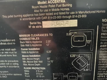

To find your stove build date look for sticker on the side. I also got floor model in 2018. Built in 2014. When new model arrived I got it at 1k discount. It had very little use in the store.
The wire was white. The repair guy said they only had red and black, so I don't know what's up with it. I don't know the year because I bought a floor model and this is only my third winter with it. Serial # is 2624.
There isn't a sticker on the side...or the back. Just the serial number.

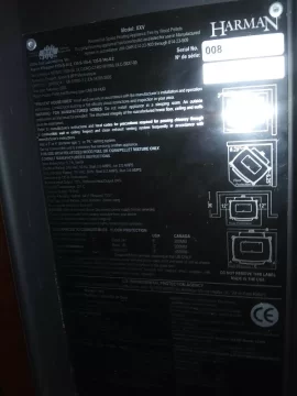

The Data Plate is Riveted In. Looks like this I bet. Look at the Bottom of the Plate for Date
  • [Hearth.com] Harman Accentra Problems
Here is mine. This thing must be older than I thought.

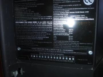

Well, this is interesting. Looks like the place where I bought it somehow cut off the manufacturing date. Look closely at my pics.
Pull that plate you may find that the date is under it
Reactions: Washed-Up
I'll bet if you peel back that lip a little you will find the rest of the sticker is under it
not cut off just covered by the lip
Reactions: ABusWrench
In the picture of the esp, the tag says 12-24-02. I agree, the rest of the tag is under the panel lip.
