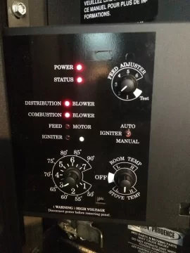

Hello all, I have a Harman Accentra that is about 8 years old and have a few questions.. I have a 1918 brick house that has zero insulation in the walls. I was told when installed I could run in either room temp, or Stove Temp.
What I have been doing over the years is burn a bag a day but no more due to the home inefficiency. This year it seems to want to burn more then 1 bag per day.. I can't seem to find the correct settings.. I typically get the fire started by the auto button and then turn it to manual. In years past I was going through an igniter a year which the company said was caused by leaving the igniter on..
So the setting is manual and the feed is on 1 and it still wants to burn more then a bag a day..
Any help would be appreciated..
Also, If I turn to Stove Temp the combustion/blower light turns off unless the igniter is set to auto.. So I would be fine with this as long as the igniter doesn't burn out..

Thanks for the info.. The house has 3800 sq foot.. I have added (bats)insulation in the attic, 44 new windows, new boiler.. I have thought about blowing insulation from the inside through the plaster but don't know how effective it is..
This is a fireplace insert.. At this point I use it as another source of heat vs primary. I am ok with this setting as long as the igniter doesn't burn out.

I don't know that the igniter should be staying on in that mode. On my P61 in that mode once the fire is established and the ESP picks up the heat the igniter circuit shuts off as indicated by the light going out. but the stove is a 2013 model too.
