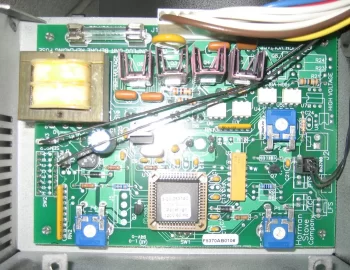

How do you know what the board version is? Here's a pic of mine [Hearth.com] Harman battery backup
I guess a good thing about having to replace the control board on the stove this week is to take advantage of the shutdown feature. I just wished it didn't have to cost $250.

Depends on the control board revision you have. I think it's from Rev D. or newer it'll pick up on the stepped sine wave.
The New boards started in Nov. 2010 as Rev. E. So anything newer than 2010 will have the new board. You can tell by the white sticker on the back of the board with the date. My old one has 2005. The new board I put in if I remember correctly has Rev. E on it. Also the restart of a store with the Rev. E board is controlled by the ESP temperature. If the ESP reads sufficient temperature it will restart when power is restored. If it goes below a certain temp. it will shut off and stay off until reset.
