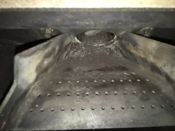

Hello
It really is not that simple guys!
The latest burn pot mod that Harman made adds an air channel to the back plane that we call the Fluted Burn Pot. This goes with a new flame guide that has to notches in the back corners to let that air out to push the flame forward away from the auger and fire brick. Therefore with this latest mod you can have more air holes for better performance.
I just upgraded an old Harman Advance with the black metal hopper lid to the new burn pot and flame guide.
See 1st pic below with new pot in front of the old pot.
New pot has 6 rows of holes
Old pot has 4-1/2 rows of holes.
2nd pic is old burn pot cleaned up to clearly show 4-1/4 rows of holes.
Now here is the kicker. Harman standardized this new fluted burn pot for the P43 and other models
Burn pot part # 1-10-00675
See more pics and other models like XXV and accentra insert. :-)
http://www.stove-parts-unlimited.com/P43-XXV-Advance-Accentra-Insert-Burn-Pot-p/1-10-00675.htm
