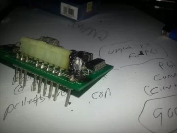

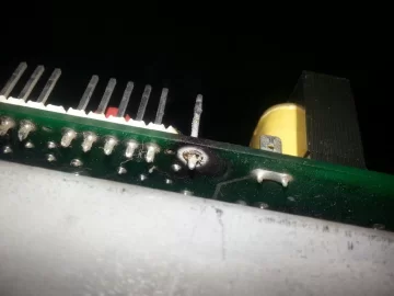

Thanks everyone, I have a friend that is an electrical engineer he actually builds custom boards for defunct pinball machines among other things - he has them now and says they can be saved. They seem to always fail at the two hot pins where the boards first meet the 120V. He found a replacement pin set and is going to solder an additional "runway" to support the area. We shall see.. I'll be getting this back in a couple weeks I'll report back. I'd be wise to buy one of the enhancement boards if I can. It might be worth it to just it as it took the brunt of the damage. MSmith66 would you be willing to share the information :) I'm in Central NY as well. 607-432-0186.

I think mine shorted at the same spot as yours. Brunners seemed to be familiar with the fault, and said that after their repair it shouldn't happen again since they used superior components.

Ok update, got the board repaired and it looked good. Plugged it all in and nothing. The tiniest sign of life can occur when I pull the fuse out and back in. When I do that the feed motor runs for 1/5 of a second sometimes. Other than that no sounds and no lights. He said to give it back to him with the wiring diagram. Not sure what if anything is next for the "Invincible"... Any feedback appreciated.

I just went through this with my Invincible T. I ended up bypassing that worthless connector entirely and jumpered around all of it using stout wire and proper connections. I also reverse-engineered the "Enhancement" board because the feeder motor would make all kinds of weird noises when the stove was off and plugged in - turns out all it does is cycle the feed motor as long as the exhaust blower motor is on. I added a small Resistor/Capacitor snubber in there and the problem went away.
