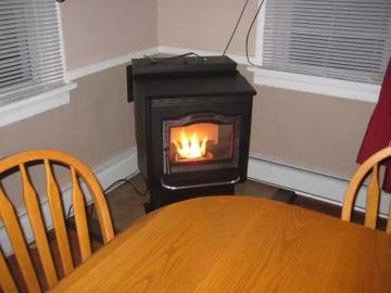

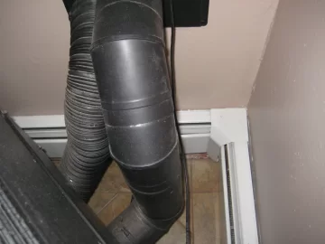

I have the corner installed P61A and my OAK pipe is alway cool.or cold depending on outside temps.
