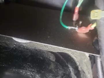

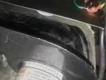

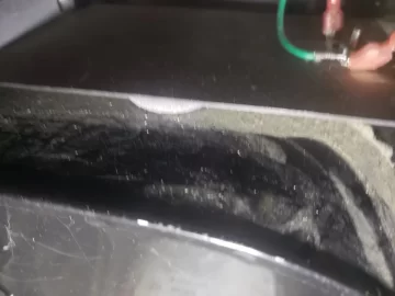

Ok. Took a picture this morning. You can see a rubber pad between the blower housing and a plate that has connections attached to it. Looks a bit white in the picture but it's black. When I lift that square plate up a little bit I can tell that that pad is attached to the blower housing. Pushed that plate up a bit and it's has a sticky surface on the blower side so nothing screwed on. Looks like it is there so as not the vibrate against that metal plate above it. Bought the stove new in 2014 so it's not a homemade damper. in retrospect, looks like i can just shove a piece of foam rubber or similar between that plate and the blower housing [if the original damper will not stick anymore.].

Must be something they added on the later stoves, I've never seen one on any of mine. As a matter of fact, I don't believe any of mine have the ground connections on the (heat shield?) that is in your pictures.
The grommet you show the link for is just a protector for wiring, tubing etc., but I'm sure you already know that. When you do actually make the swap, let us know if you find there is enough clearance between the two so the bumper is not needed.

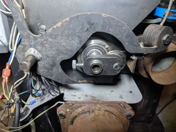

I was wrong about the ground connections; this is a picture of one of the P61's that I changed the feeder weldment on; it has them so the others may too! No bumpers though, I know that because I always remove the blower housing (two bolts) when doing the annual cleanings.[Hearth.com] harman P series distribution blower.
