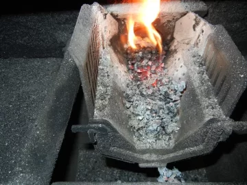

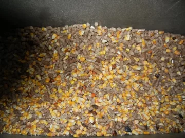

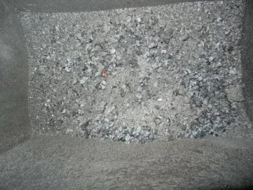

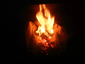

Enjoying the burn this AM. Very low RM corn blend 50% on the pellet tray. Wish I could push the camera to get better pic of flame.
