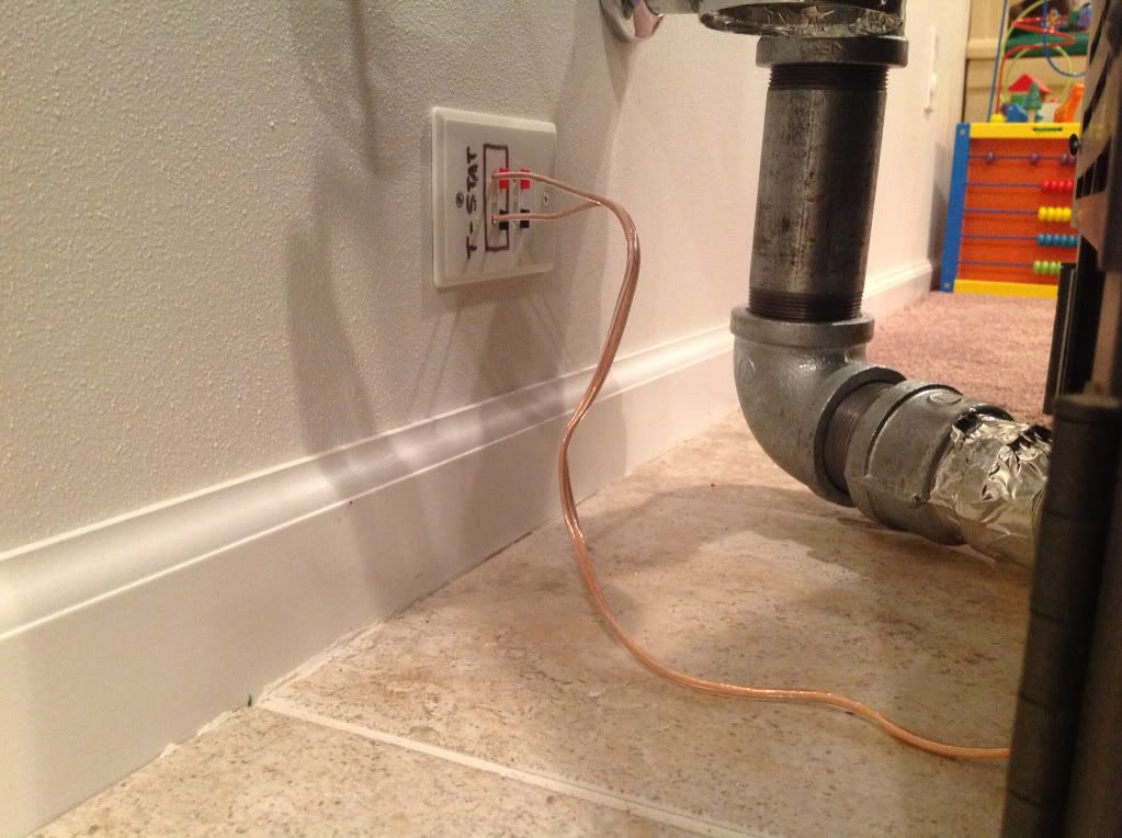

Very nice install and I really like how you adapted your own OAK. :)
Can you give us a zoom picture on that? ;) What size fittings did you use from the plumbing dept to accomplish that? Will that vacuum cleanout vacuum attachment work with any T? I plan on using PelletVentPro.
wow the scrap value of your air intake has to be awesome.
Eric
Reactions: SmokeyTheBear
The fittings are 2" galvanized.
I think the vacuum clean out is just for Selkirk VP piping. And my surge protector wasn't hooked up in that photo but is now!
