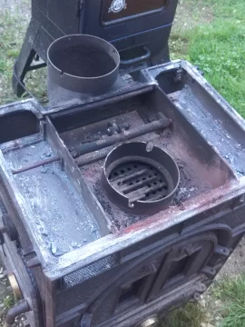

I was recently given this stove, a Dutchwest FA224CCL. I'm hoping to swap it out for my Englander steel stove to Lord willing achieve a longer burn time with the cat, cast and slightly bigger box. So far I have replaced the door and glass gaskets as well as the top plate gasket (holds the cat probe). This morning I got the top off it (thanks to a comment on this forum which talked about the connection on center front under the top) and today will work on the flue gasket. I've ordered a new cat and the Interam gasket for the cat. My questions are:

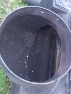

1. How concerned should I be about my "oval to round" flue? I've seen some chatter on that issue but don't really understand the issue.
2. Rope gasket or furnace cement to put the top back in place? I like the idea of the gasket but am aware it was cemented in the past.
3. I noted in the manual information regarding "double wall pipe" transitions "needing to be on an approved list" or something. Concern being pipe heat potential.
(my setup is 8' of straight steel single wall stove pipe into a transition to larger exterior double wall stainless at the pass through. The existing chimney was done by a local reputable company about 12 years ago). If anyone can shed light on this potential issue it would be greatly appreciated.
4. Some minor surface rust in a couple spots, stove paste or paint after steel wool?

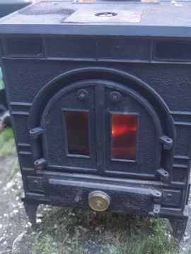

The fire pictured was run outside last night to burn in the gaskets i put in. Cool little stove!

Update:
I have replaced all the gaskets (there's a bunch), bought a new catalyst and interam gasket and the front plate for the fire box (keeps wood/coals off the doors). I went with gaskets for the top in case i need to get back into it. Fresh coat of paint after rust removal. Running my 2nd burn cycle and I must say this is a phenomenal design. I need to get a new cat probe but I activated the cat and she's running like a charm. Just in time! Sweet little stove. I think I have maybe $400 into it at this point. Got it for free so winner winner chicken dinner. Very likely the end of night time fire duty! IFYKTYK lol. Oh and per the plate on the back although it was built eons ago it wasnt sold til 2012! Meaning it only had a few years use.

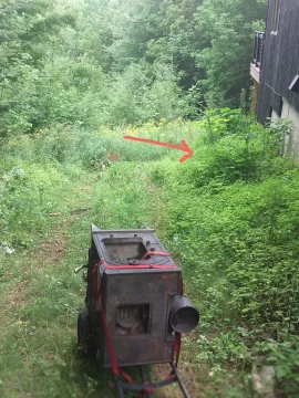

Fall Update on this stove. I am soooo happy I took time to work on this as a project this summer. (there was some serious sweat involved getting it up a hill on a handtruck-see photo). They truly don't make stoves like this anymore (see EPA tomfoolery). The design and overall tightness are very impressive. The air control knobs are like the burner on your stove in terms of response. The convection heat factor is huge. I'm greatful to this forum and the parts suppliers out there like MWH and Woodmans.
