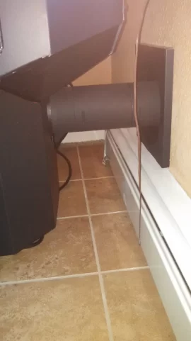

Thanks for the reply Spock. I must have linked the wrong thimble because I just measured mine and it's 12x12, not 9". Here's an actual shot of the install to give you an idea of what I'm working with. I know I could just pop another hole through the wall next to the thimble and route the OAK that way but it's pretty tight between the thimble and wall and I'm leery about the room (keep in mind, there's a stud there too).
Can anyone who bought the OAK kit confirm that the thimble is much wider or is it similar to mine?

Your wall thimble looks like the bigger one for the oak. i could see with 12X12 that you could get a 3" hole outside of the thimble walls. my original thimble (duravent) there was no f'ing way i could've put an oak into it. maybe duravent discontinued the old size and now sell the same size thimble with and without the oak hole in it. would make sense from an inventory management and a economies of scale perspective.
Duravent sill sells the small 9x9. I installed my stove last month with one.
