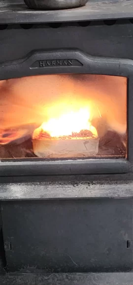

I have a harmen P43 stove. Light's fine gets going throttles up. Then for some reason, it does not feed aggressively enough, it keeps a small fire in the pot even when turned up all the way. The level 7 or with the temperature, the probe turned all the way up to 90° it does not feed excessively aggressive. It used to feed and have a very large fire in the box. And heat up the house quite well.
So far, I have taken the ESP probe out and cleaned it with no change.
Thank you for your time.

Does it act the same in stove mode? Stove mode would be the mode where it is just based on internal temperature. Say, stove mode, feed rate 4, setting of 4. Also, can you verify it is cold in the room without the stove running? Can you also look at the LED light for the feed/auger. How many seconds does the light stay on, and then time to the next feed cycle.
Yes, it's actually worse in stove mode. If I put it on stove mode, Max setting, the flame is less than room temp mode. I counted it out on Max setting 6. I'm getting about 25 seconds worth of feed. Rate on room mode and I'm getting about 22 to 23 on stove mode.

So I checked the stove with The draft meter it's within spec. I don't have an external air supply. It pulls from in the house

So I just did a full clean and changed the ESP stove is running good now. I'm pretty sure the ESP was bad because the stove wasn't excessively dirty. It had only gone through. about 1/2 a ton since last full cleaning.

So in the end, the ESP pro I believe was bad as the stove is now running perfectly after a cleaning and a new probe. I did check to see if the probe was loose. It was not. I also checked to make sure that my room temp probe was fully seated, and it was. With single degree temps coming up. I just hail married it and chucked a new probe on it. And it worked great.
