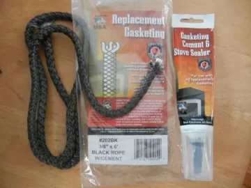

PJPellet, where did u get your gasket set from & did you do both doors ??
I bought my supplies from Amazon. I only replaced the main door gasket because I replaced the ash pan door gasket in 2013 and it still looks very good.
Also, I purchased the type of gasket recommended above AND the adhesive recommended above. The new one looks better than the old one.
