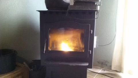

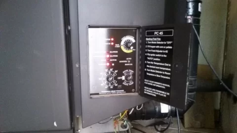

My P45 has been recently thoroughly cleaned, it appears sealed and should be working fine - as it did last season when we quit using it.
To get it to start running I have had to manually feed the burn pot with about 1/2 a coffee cup of pellets every 5 minutes until it warms up, about 6x.
Then to keep it running the feed adjuster is set on 6. I used to keep the feed adjuster about 3.5-4.
In observing the feed indicator light and listening to the auger motor, the motor only runs about 1 second unless the adjuster is set on 6, then it runs for about 2.5 seconds.
The attached pictures are of the stove's settings and the resultant flame after being on for 30 min .
Any help of where I can do further investigation is appreciated - the local dealer is no help diagnosing the problems but will happily, "...send out a tech @ $80/hr so they can learn to work on Harman stoves!"

Harmans can act weird if the voltage polarity is not correct, but I'll assume the stove is plugged into same outlet in which it used to work just fine.
Wonder if exhaust probe was bent and damaged the last time it was cleaned. Its sounds like the control board is not seeing a successful light of fire so mot feeding more fuel. When you manually get it hot for a long while it keeps going with a higher feed rate.
More clues would be helpful thiugh.

From what I've read the probe varies capacitance with temperature but i dont have a spec to reference. Re-reading your OP you state it feeds ok with rate turned up to 6, but not well below that. The feedrate potentiometer maybe going bad in certain positions. Try a manual start with it set in 6 instead of your normal 3 or 4 and see what happens. My past pc45 needed a really hot initial fire to get auger feeding, and then the feed rate ramped up very slowly compared with p61 or p38 units. Think this has to do with it being a corn stove which are careful about not smuthering the fires.
Anything changed from when it ran well like DIP switch positions, or exhaust restrictor plate type (corn or pellet), auger motor, etc?
Age of stove and any other maintenance recently? We should be able to get to the bottom of the issue. But leaning on two possible issues.

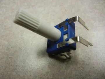

You won't see any issue with the pot switches as they are pretty self contained. I would not pull the board at this time. Pictured

If running ok,try gently wiggleing the knobs on the pots and watch for changes.If board has something visual it prob. would not run properly,however unplug all connections and inspect,look for burns or slight corrosion.
