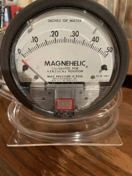

Next trip out to the barn and I’ll take a picture. Need some1/8 tubing and I bought those fittings .
Here you go, couldn’t find it on Amazon ended up getting it of eBay.
Great! Thanks for the info.. will look into getting one. .. Are the fittings you posted above everything I will need to attach it to the stove? .. I see there is an access bolt on the left rear corner of the stove firebox. .. And what's the T fitting for? It's not just gauge -> hose -> stove?
I believe so. I teed into the connection on the draft pressure switch. My stove is an accentra. Hope it’s not too much detail, but combustion fan is a volumetric device. At high elevations, the air density drops so not as much air is being moved by the fan. So fire burns lean and less air to cool the metal of the burnpot. Add the restrictions on the oak and it might causing the issues.

I would doubt that you will see much difference in vac with the inlet fitting In or out. Put the sove in start up withe the rear guard off And vac guage hooked up. Then take the fitting loose from the stove and see if the needle moves. The low draft adjustment only comes into play when the stove is at an idle.
